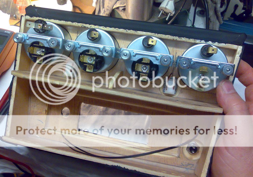

the first prototype has an interference to my odd AC evaporator, so starting from scratch again:
increased the slope between the two planes, thus it became thicker, and had to remove from back for switches
most amazing switches, original lucas from jaguar cars
bits:
process
check
protect with varnish
cover in leather
compare slope
install the bits
dequincey
cables and fastons
radio connections:
switch and light to actívate electronic antenna
using the holes in the Wood to tie the cables
diagram for gauges:
Po=pressure oil
To=temp oil
Tw=temp water
Volts
G=signal from sensor
a plate for the fuse
fixed by means of pop rivets, this position is great to change fuse, only need to open it a bit, dont need to remove the whole thing out
detail:
lots of cables: but not messy
one unique connector
ready:
to make it fit to the hole by means of pressure, and not using any screw, i place a 5 mm neoprene strap all around (makes assembly reversible for a future purist buyer ;-) )

dequincey
De nuevo,…..
Start the process again,
fdd308ed-543d-45a6-8e35-50d1a9011615-jpeg.178786
I have to remove the cables from the old one
fb51d311-b003-44ad-a6b3-cf4c1302dbdb-jpeg.178787
c3950f5c-9605-4c04-b557-e5a9466a212b-jpeg.178788
afffb92d-56c9-4e79-b450-f9c0301eb0ce-jpeg.178789
0e7c2a75-f23a-4949-a236-0723de03c947-jpeg.178790
dequincey
¿Y eso de repetir?
¿Para algún amigo, o es que vas a poner una Android Auto chinorra? ;-)
explicado que con el cambio de las consolas han quedado más estrechas
Por eso ha habido que hacer nueva
Y también por la nueva radio “chinorra” que tiene función de antena
