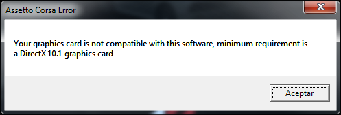

    Para este error:
    Ok guys, the update is up.. to enable your ANCIENT :p UNSUPPORTED :p cards please edit the file:
    system/cfg/dx11.ini
    this line:
    ALLOW_UNSUPPORTED_DX10=0 ; UNSUPPORTED USE AT YOUR OWN RISK
    becomes
    ALLOW_UNSUPPORTED_DX10=1 ; UNSUPPORTED USE AT YOUR OWN RISK
