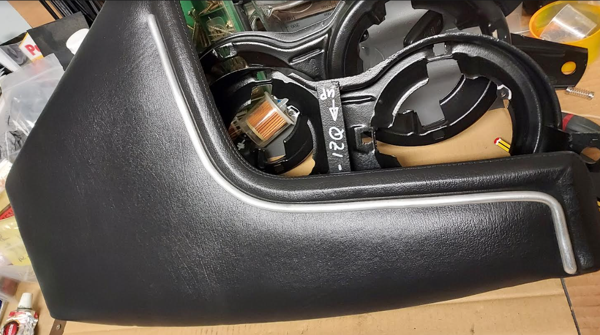

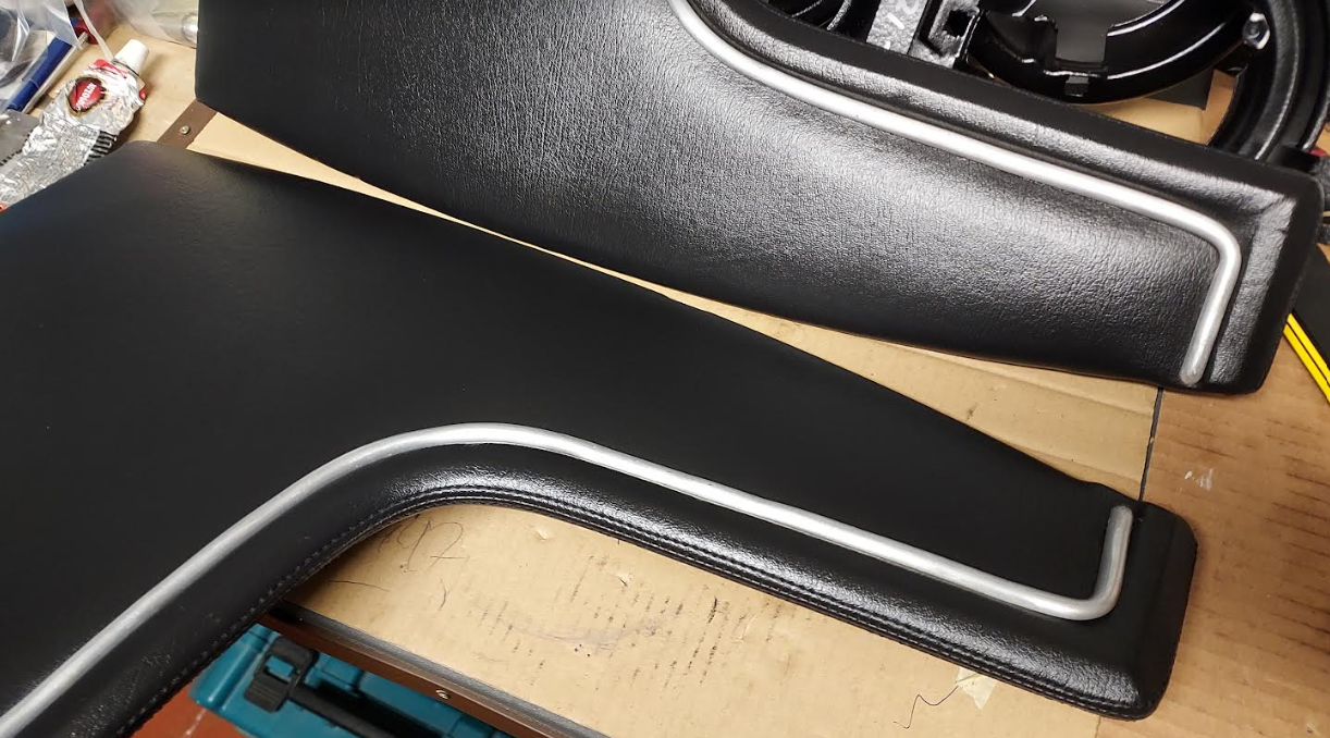

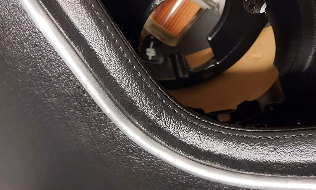

I have learnt something about these parts, the lateral console Wood panels are in fact of two types of Wood,
a poor agglomerated Wood for the non AC versión, and plywood for the AC versión
these parts usually suffer when in the car, but much more prone to damage when removed, the AC versión panels are particularly delicate as there is a huge opening that leaves a thin Wood arm in the bottom,
usually these áreas need to be recovered , so here is the process, it is a long and tedious process using Wood mastic and lots of patience:
this piece was gone (see up right corner)
the other piece, inner side:
replacing the foam:
the thin rail around the opening:
replacing the foam:
fixing points:
