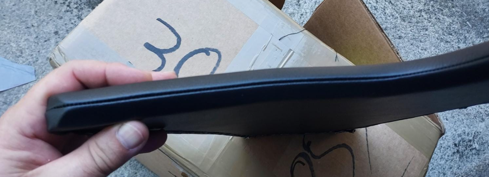

paneles de consolas laterales:
as to the wood that was finished months ago it still needed the rubber and the foam, so...
so, once all this was ready it only took 2 hours to complete the upholstery process,...i am getting old...
most difficult part is to get the edges inside the rubber channel...
start in one corner back side
then turn other side and pull while puting staples to fix
keep the tension and work the other end
tools
relevant:
ready for the alu trim lines
