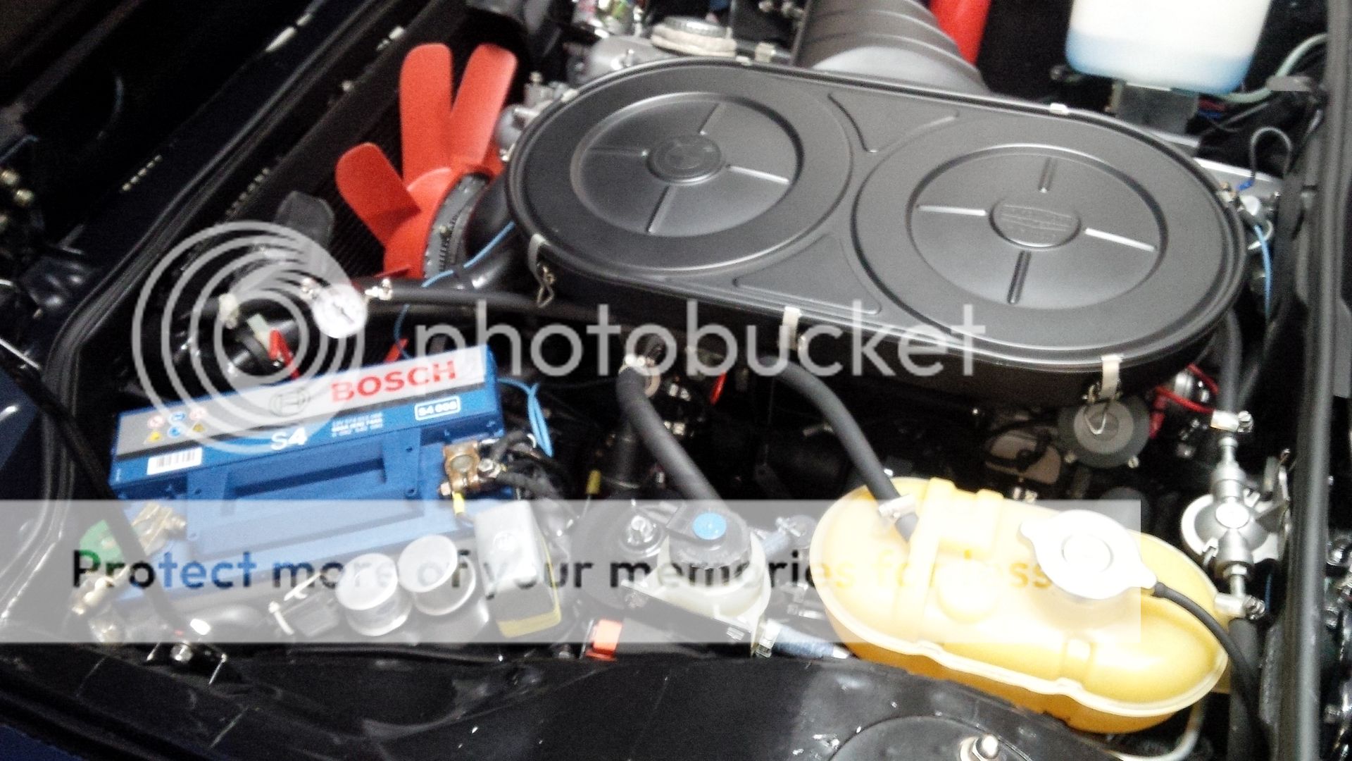

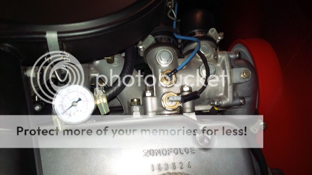

    i would like to check the pressure that the fuel pump is able to give, there is this or other similar kits that contains the elements to be able to do so
    the usual setup for a CS is this one
    obviously there is not too much room to put the pressure gauge at the output of the pump, moreover, once the air filter cover is in place you can see nothing
    but the hose that goes to the front carb is free and in a good position to hold the gauge
    i learnt, from the specs book that mechanical pump should give 0,21 to 0,25 bar at 4000 rpms
    so my questions are:
    1- is there a chance of meassuring fuel pump pressure output ? you must consider that when the carbs are refuelling their reservoirs, and thus their floater valves opened, Pressure = 0
    2- provided that both carb floaters are closed, do you think that the three pressures are equal ? i mean: ( P = Pr = Pf ), i think so
    3- wich are the odds of those two floaters to be closed simultaneously ? very rare / almost all the time / once every x engine cycles ?
    thanks for your help

    here comes the praxis, after some empirical moments...
    0,2 bar at iddle
    and 0,2bar at any rpm,....no variation
    and obviously, when engine is stopped pressure remains,
    the setup adds a bit of control illusion to the engine bay ;-)

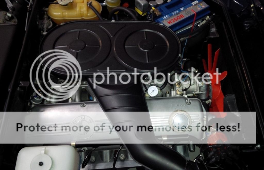

    OK, deja que vuelva a casa y las cuelgo. Lleva montado unos dos años, es de 1,6 bar, y en operación normal, se mantiene sobre 0,6 a 0,7 bar, si le achuchas llega a unos 0,8 Bar, si no recuerdo mal la apertura del tapón está a 1 Bar. Si no pasa nada el fin de semana salto el charco, así que la semana que viene, en este currordenador no tengo fotos "personales" biggrin
  15. saicaman
    26 Dic 2003
    8.598
    2.377
    E24 G30
    La verdad, es que ya colgué fotos y las he localizado :)
    El manómetro de gasolina, como comenté tras el pulmón de amortiguación y antes de la rampa
    Y el del circuito de refrigeración, como comento está intercalado en el manguito de retorno de la parte superior del radiador al bote de expansión, es un punto con circulación permanente.

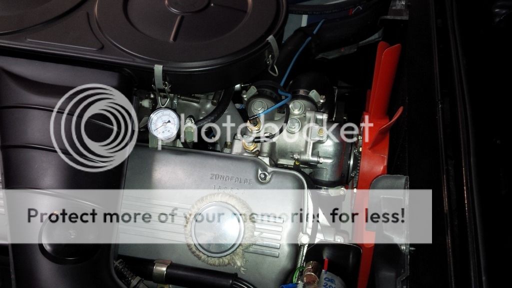

    me he apropiado de la idea de saica,
    0,28 bares de presión de refrigerante
    saludos
    answer is:
    0,28 bar is my coolant pressure, this one increases a bit when rpms go up, i have been able to read 0,35 almost 0,4 bar
