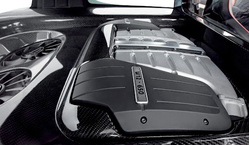

    ENGINE SWAP DIABOLICO...
    UN E39 CON V12....
    BMW 560i MVR "Martin Veyhle Racing"
    Engine : 6.1Liter V12Engine
    Horse Power: 440Hp........ bye bye M5
    Top Speed: 310Km
    0/100: 5.3s
    Gear Type: F1 Gear On The Stearing
    This vehicle was originally a new BMW 540i that was modified by a specialist German tuner, Martin Veyhle Racing (MVR), in Stuttgart. The original V8 engine was replaced by BMW's V12 engine modified to 6.1 litres. It resulted in 438 BHP at 5,400 RPM and 620 Nm of torque at 4,300 RPM. Other developments include those to the brakes, gearbox, suspension, wheels, tyres, interior trim and the instrument panel.
    With these upgrades in place, the BMW MVR 560i boasts a blistering top speed of 310 km/hr. It is capable of accelerating from 0-100 km/hr in 5.3 seconds.
    Due to the expensive cost of the project, only 20 of these vehicles were ever made.
    E39 With V12 Engine .... [MVR 6.1] - The Unofficial BMW M5 Messageboard (m5board.com)
    disfruto de la foto del engine bay y la del v12 en el baul...que locura!
