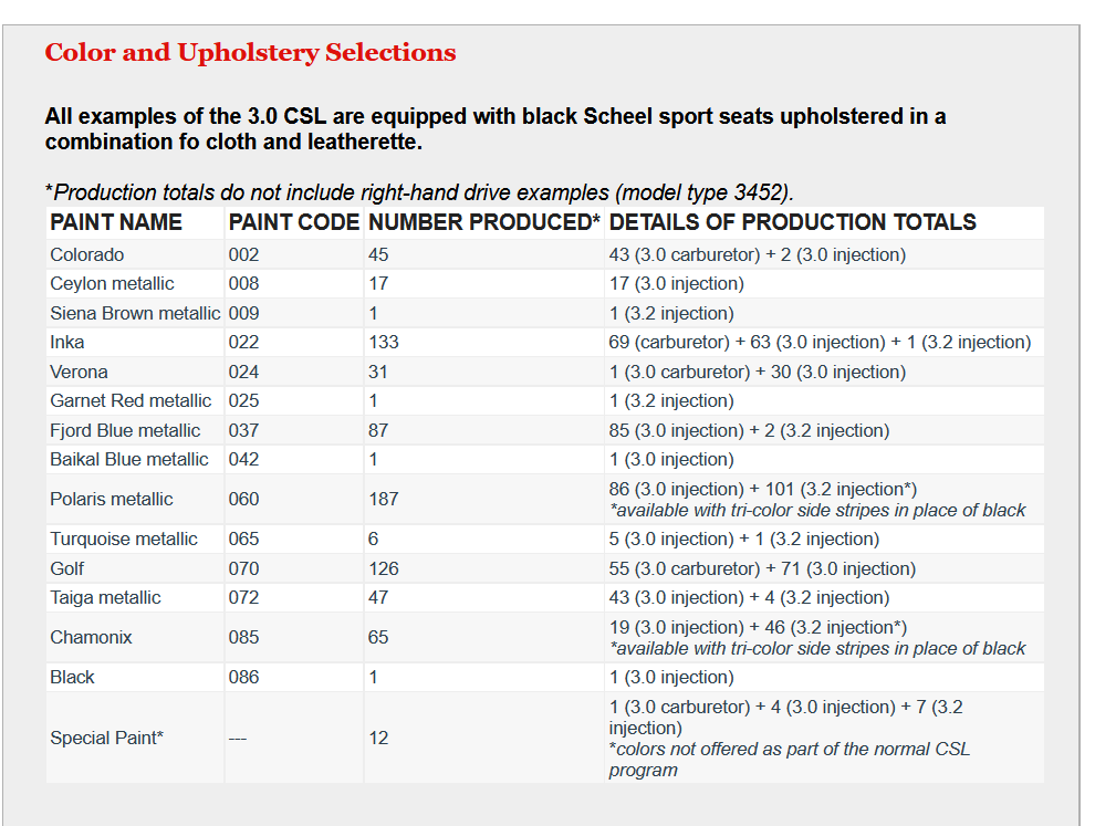

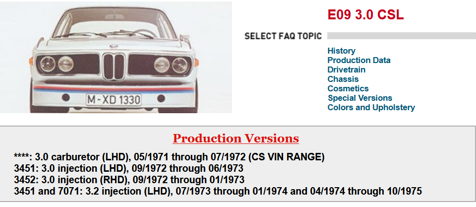

How many versions of the 3.0 CSL were developed?
BMW developed four different versions of the 3.0 CSL over five years, all to European specification. The original version, produced in late 1971 and early 1972, utilized the standard 2,985-cc M30 engine with twin carburetors and was only offered in left-hand drive. A fuel-injected model displacing 3,003cc then replaced the earlier carbureted version and was produced in both left-hand drive and right-hand drive forms during late 1972 and early 1973. The final iteration of the 3.0 CSL, all produced in left-hand drive and with a larger 3,153-cc engine, was built in two distinct production runs during late 1973 (first batch) and 1974-75 (second batch).
How many of each version of the 3.0 CSL were produced?
3.0 Carburetor (LHD): 169 produced from 05/1971 through 07/1972
3.0 Injection (LHD): 429 produced from 09/1972 through 03/1973
3.0 Injection (RHD): 500 produced from 09/1972 through 06/1973
3.2 injection (LHD): 110 produced* from 07/1973 through 01/1974, 57 produced from 04/1974 through 10/1975
*76 produced in Polaris metallic, 33 produced in Chamonix, 1 produced with Special Paint
Where was the 3.0 CSL produced?
Like all 3.0-liter E9-series coupes, the 3.0 CSL was assembled at the Karmann Werkes in Rheine, Germany.
Does the 3.0 CSL have a unique chassis number sequence?
The original carbureted CSLs were based upon standard 3.0 CS production models and therefore have no unique model code or chassis sequence. Instead, their chassis numbers (VINs) fall within the normal 3.0 CS production sequence. However, all fuel-injected CSLs have a unique model code and chassis number sequence. Fuel-injected CSLs with the 3.0-liter motor have VINs that run from 2275001 through 2275429 (left-hand drive version) and 2285001 through 2285500 (right-hand drive version). The final 3.2-liter CSLs (commonly referred to as "Batmobiles") have VINs that run from 2275430 through 2275539 (first batch) and 4355001 through 4355057 (second batch).

How does the interior of the 3.0 CSL differ cosmetically from the standard 3.0 CS/3.0CSi?
The interior of the 3.0 CSL can be distinguished from that of the 3.0 CS/3.0 CSi models by its unique three-spoke leather-wrapped steering wheel and Scheel sport seats in black cloth upholstery with black leatherette bolsters. In addition, the roof lining is also black.
