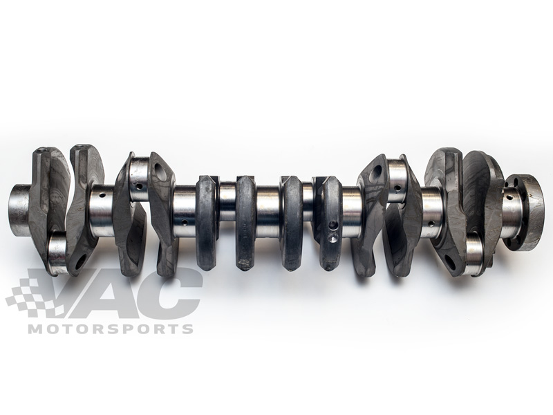

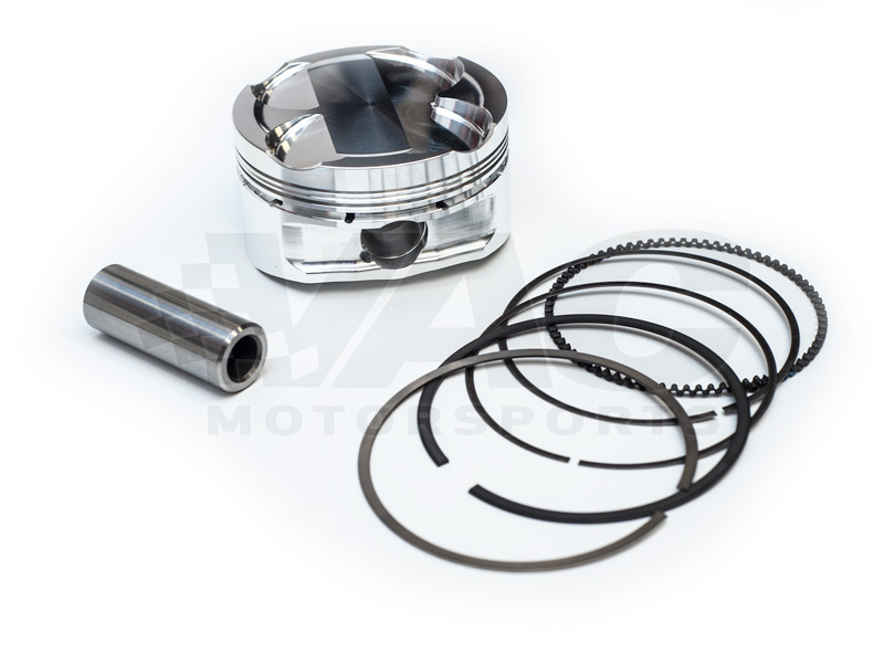

Y esto qué?
VAC STROKER KIT (BMW M50/M52/S50/S52) 3.3L/3.4L/3.5L
M50,M52,S50,S52, M52TU, M54TU U.S Engine ONLY
Crankshaft: superb quality, made to our specs:
  • Machined from the best-quality steel billet
  • Exacting specification
  • No need for non-BMW bearings
  • Properly heat-treated and finished.
Pistons: CP specifically designed for the loads and stresses of all out race use
  • Exceptional quality and consistency
  • Your choice of specs to meet your class regulations and fuel requirements
  • Balanced out of the box to a high tolerance between pistons
  • Highly durable
  • Pre-clearanced for most race cams (always check Piston to valve clearance*)
  • Includes Rings, Pins & Locks (HD pins must be used for forced induction apps)
Connecting Rods Choice: SP Components, Arrow Precision & Carrillo.
  • Closely balanced out of the box
  • Includes ARP hardware for each rod
  • Best in class Strength-to-weight ratio
  • Proven results in this stroker kit even under endurance use
Understanding Your Stroker:
This crankshaft has a 97 mm stroke
-A bore size of 85 mm gives a displacement of 3303 cc
-A bore size of 85.5 mm gives a displacement of 3342 cc
-A bore size of 86 mm gives a displacement of 3381 cc
-A bore size of 86.5 mm gives a displacement of 3420 cc
-A bore size of 87 mm gives a displacement of 3460 cc
-A bore size of 87.5 mm gives a displacement of 3499.7 cc
Basic compression ratio outline and recomendations:
13:1 - 12.5:1 [Race use] High octane race fuel
11:1 Good for pump fuel sports and track engines
10.5:1 [OE M52] Works well low-boost (>10psi) turbos, Superchargers, etc
8.5:1 - 9.0:1 [Low CR] Recommended for boosted turbocharged engines
VAC M50 Stroker Kit includes:
  • VAC Crank with 97mm Stroke
  • (6) CP Forged Pistons; with high quality rings, pins, & locks (any compression ratio/ .5mm bore increments)
  • (6) Forged Connecting Rods with ARP hardware
  • Suitable for a street car or all out racing vehicles
VAC Tech Tip:
This is a brilliant way to get more power and torque from your M50, M52, S50, S52 U.S Engines, especially due to high RPM limits with hydraulic valve train fitted as stock to the M5x family. More power and torque without revving higher!
https://store.vacmotorsports.com/vac-stroker-kit-bmw-m50m52s50s52-33l34l35l-p2983.aspx

Entiendo que el modelo de 3.3 litros tendrá las mismas cotas que los Alpina B3.3 basados en motores M5x. De todos modos una carrera de 97 mm es tremenda si se pretende girar arriba.
BLUEBIRD
5 Ene 2008
6.163
9.261
Claro, por eso mismo no es para que gire arriba:
"This is a brilliant way to get more power and torque from your M50, M52, S50, S52 U.S Engines, especially due to high RPM limits with hydraulic valve train fitted as stock to the M5x family. More power and torque without revving higher!"
  • Highly durable
VAC Tech Tip:
